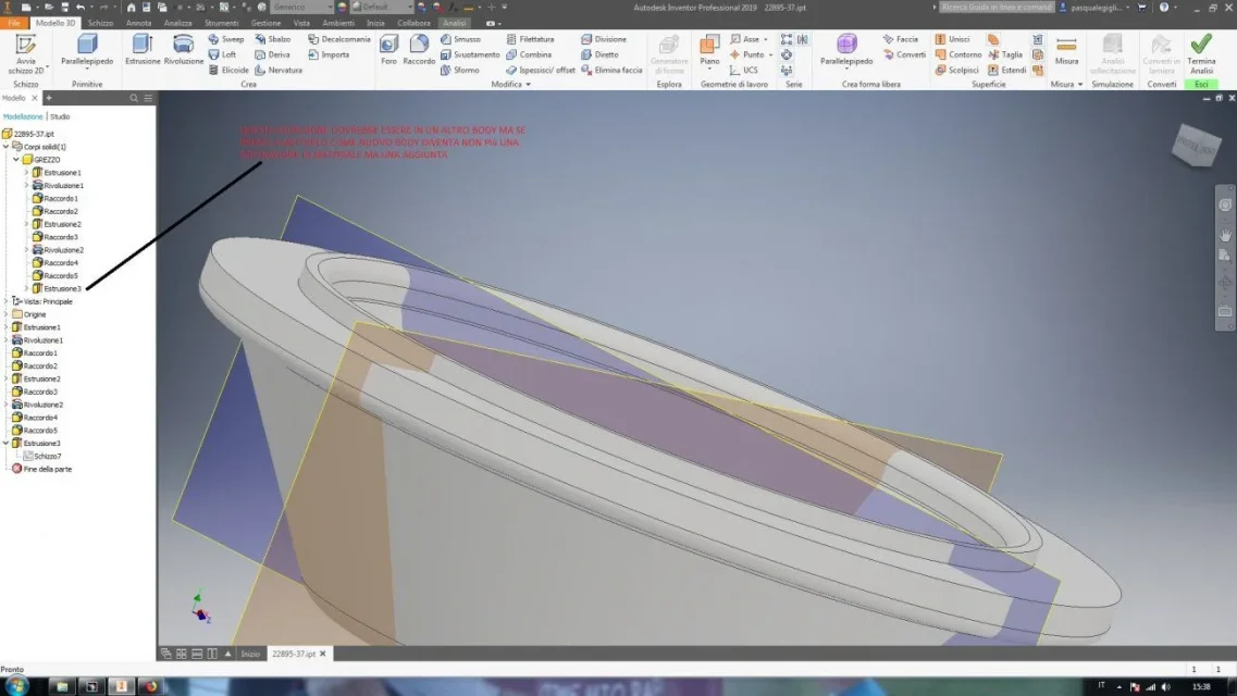

to model a welded struttra use the environment of the welded axes of inventor.
I then carry out the processing that I want with the controls of mechanical processing and get a single file with inside the two phases of welding and processing. I would now like to obtain from the same file 2 different tables containing, first the quotas for welding and in the 2nd the quotas to realize the processing (as it once did) , therefore one part will have for example a thickness of 12 mm in the welded, and a thickness of 8 mm in the working table.
I was thinking of using the representations in the rough table, but I find that unlike the environment of the general assemblies, the representations in welds are not usable (beautiful minch...). How are you doing? of course the 2 tables must be parametric.

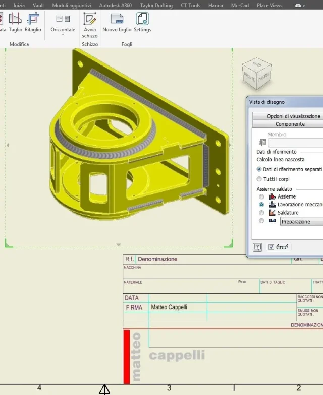

If I understand correctly, you want to take the various stages
you can also do it on a single .idw file, maybe on 2 or more different sheets, using table model status options

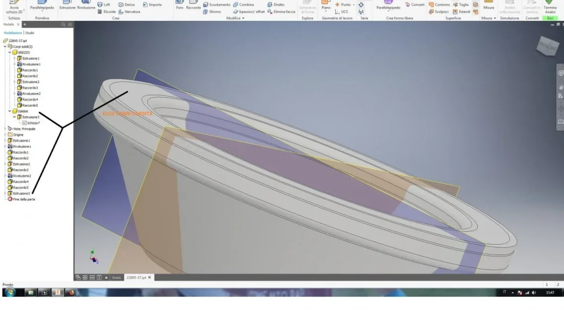

Now I ask you another question. If you have a fuss in one part, and you want to make a table for merging and crude and one for the same fusion, but for the work. how would you do that?

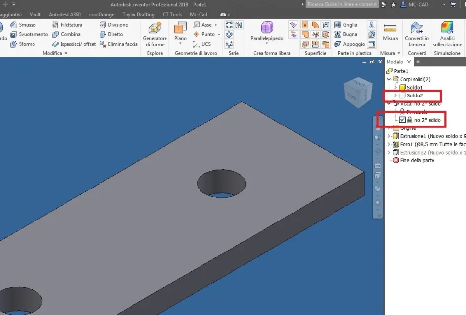

you can create jobs like "2° solid" in multibody

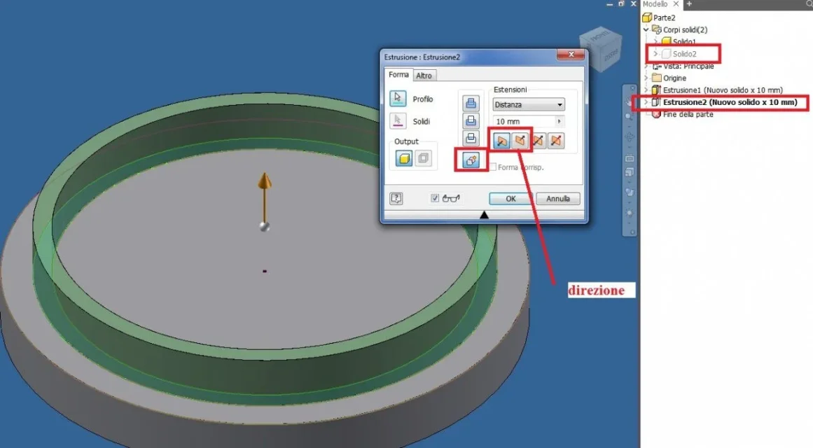

In part 3d, you can create raw and processed rapps and then generate tables with 2 representations
I'm sorry.
I have seen that you are on linkedin but do not accept links if you please send me an invitation I am alessandro scaglione designer at bisiach and carrù torino

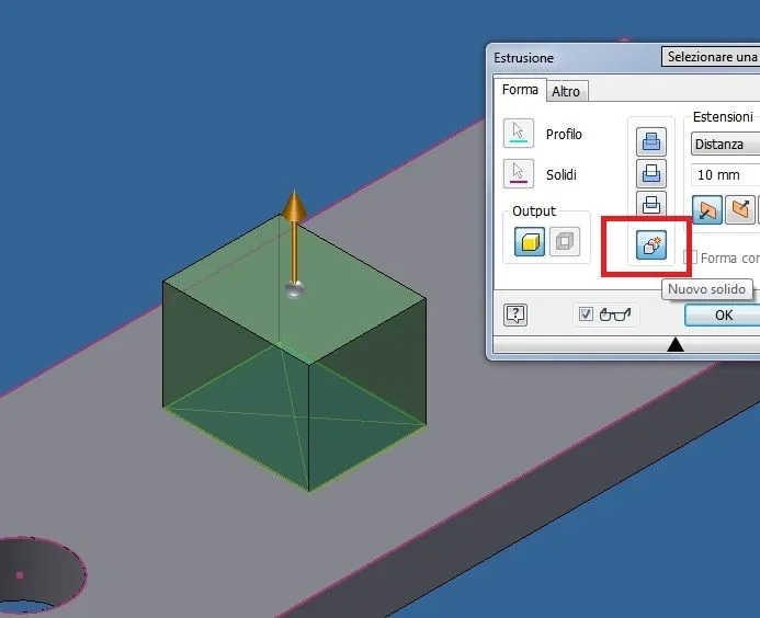

during creation (e.g. extrusion) , active "solid egg"_foto__483.webpthen manage its display and store it as a state in new representation_foto__484.webp
OK until I got there, but if instead of adding a part like a welded, I had to remove from the material does not allow me the new body... .
here's how it looks... probably wrong something.. .

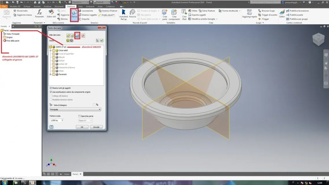

thanks to all but I solved so....
with the drift command I have the work connected to the crude and I can make 2 masses in difrferent table.
