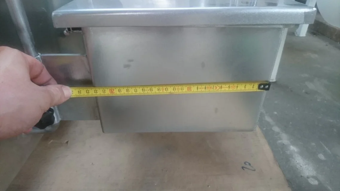

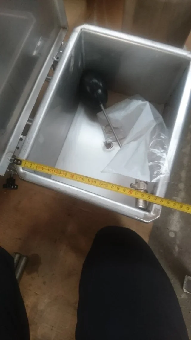

Good morning to all, I am planning to practice as I am new in this field this tub , I have a doubt, use solidworks 2019 as a program once made the solid I can not do the bevels because the command sheet does not give me this possibility!! Is there any specific command to make them and make them come as photos? Thank you in advance

However the color difference indicates that the piece was welded and then retalied with abrasive paper, so it is not said that everything was done in a fold piece
One thing you could do is:
- do sheet metal tutorials
- try to make solid and then turn it into sheet metal
those edges were probably edged and then they were cut and a sheet (type 25 mm wide for 10 mm height) was inserted and welded to the sides and then was smoothed, as seen from the photos. if so it is not a single sheet but 1 to make the whole tub and 4 to make the edges.
first you have to understand technologically how they were made.... then you think how to use the program.
thanks I had thought that it could also be produced through the funnel, the fact that unfortunately I can not smooth it perfectly this tank is used in carpentry

With funnel you don't, you can see that the edges are welded.
However you can get something like that attached
Why did you do the angled walls of 90.8°?
OK thanks, because the walls are not perfectly straight so I tried to tilt it like that.
It's as good as you did so now I try to make the other edges as well. perfect then I look good on the solid guide actually on youtube not all are good at explaining:)
