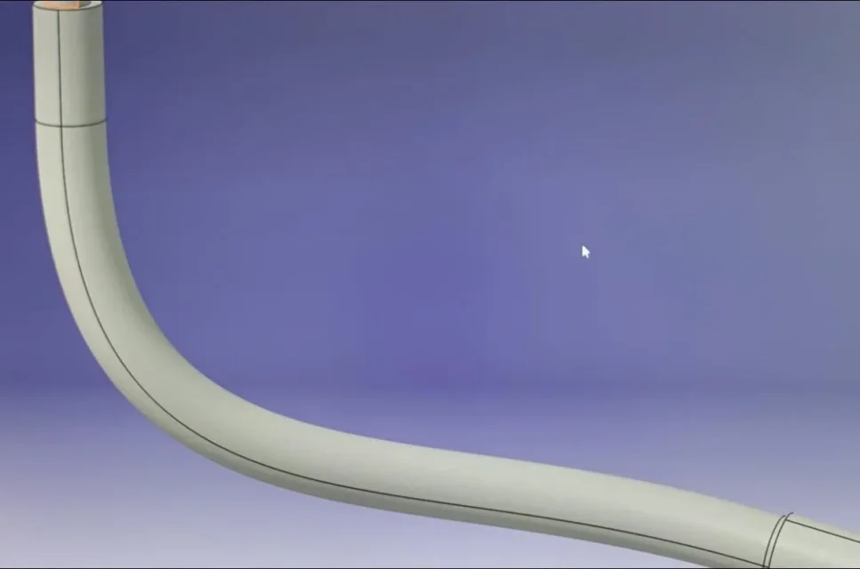

Today I have arrived some models from a customer in which there is a pipe they represent via spline, I would need to rebuild it so as to get the fold points and then make it become a kind of polylinea, how can I do? Thank you all.

07B1A970-D19B-40A0-8B8A-57201E065C86.webptomorrow morning I send the .stp file

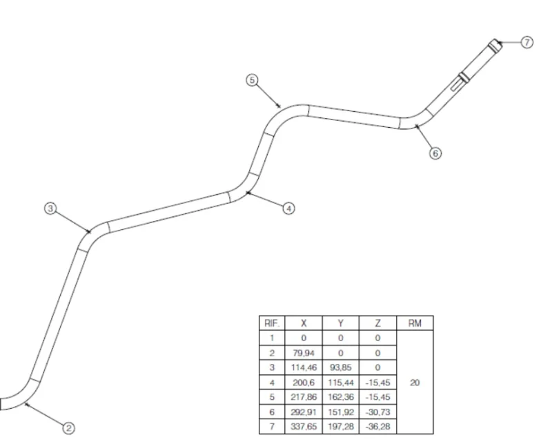

I need to get the 3d coordinates so I can reconstruct it, normally I collect the axes from the straight traits and intersect them (in the case of the spline I have no straight traits):1663049385249.webp
bho.. I didn't understand.

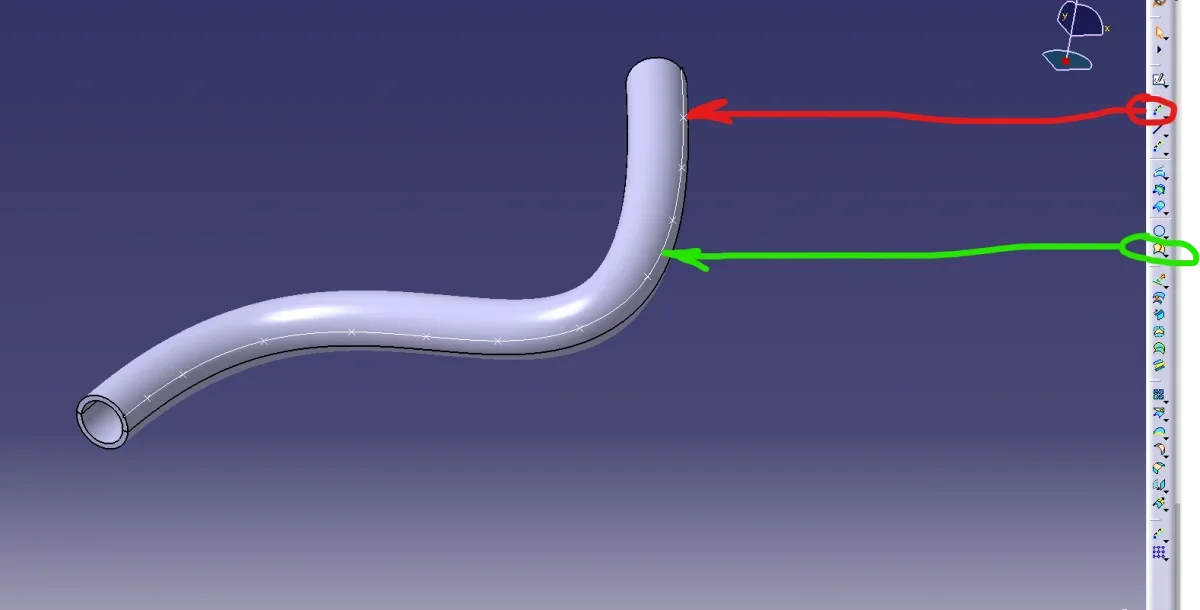

I tell you my idea
with the command isoparametric curve (green) extract the curve of your pipe in step
and with the command repeating points (rosso) create a set of points on the curve of which you will have the coordinates x y z
Is that what you wanted to get?
then if you want to create straight strokes or circle arches. .
You have all the data to do it.
