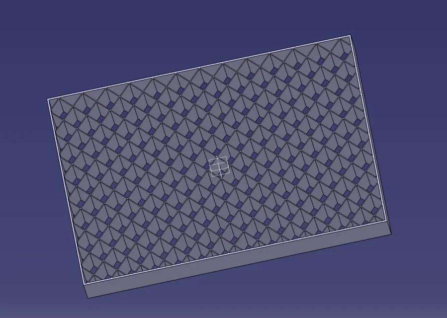

You want to do this? ?
If you... copy the grid sketch, build the outside rectangle, and on a sketch make all those of a diagonal constructive and on the other the others then extrude them giving a thickness ........ always be what you wanted
Thanks a lot, guys. At the end I managed to do it as it was to say "female". i.e. first I modified the sketch leaving only the diagonal lines in one direction, I then extruded them as z surfaces and then these surfaces offset them from both sides, closed above and below and from I recovered the solid. to have the grid finally mirrored the solid. Now that I read your messages, I think I'm pretty dumb as a procedure, but in the end I managed to create solid. Surely Monday I will try with the methods you gave me. you were super, I keep you updated.
If you feel what I told you... directly extrude the lines and you can in the same command give a thickness............. without moving from the surfaces.
cmq is good also what you have done, the important thing is to get to purpose.
