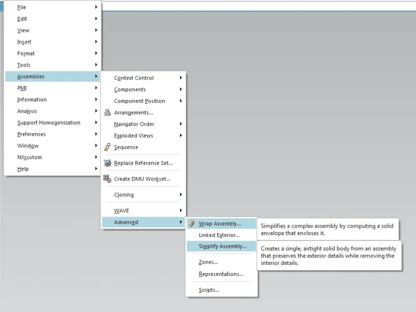

I have a cnc machine designed with nx and I would like to print it in scale with a 3d printer. Is there a way to simplify a single body assembly by extracting only external surfaces (the skin of the axieme) and filling it?
I tried, but the machine simplifies me too much (it almost creates a cube with the external encumbrance).
instead I need to keep the outer surfaces and fill it inside....or something that brings me the 3d axieme in a printable model in 3d
Maybe I say a cabbage but you can't import all the solids of the axieme into one part with the wave geometry linker and then join them all together?
I have already tried so, but unfortunately not all the components touch and many sheets are thin, so when then the port of call to print in 3d, the thickness is too thin and "disappears".
