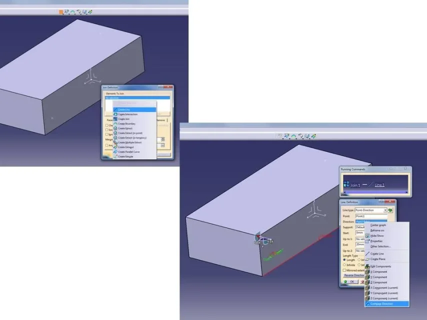

I need to make a 3d sketch in catia v5, to routing a pipe.
for the moment all the roads I have undertaken are not very practical...:frown:
How are you doing?
Is there a 3d sketch command of solidworks?
but since you need to create 3d profiles to make pipes with catia you can do using a part/superfici mix I do them normally. If you have problems I will post you something.
the union command of generated shape design allows creation of commands to nest you of straights which in turn can be defined as straight point direction.
the direction imposes it by orienting properly the compass see photo.
