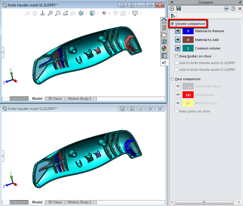

At this point I can see the differences between the two versions, but I do not have a tool that automatically indicates the different value? as I said before the 4 blue seats are indicating that they are different, but I do not know if for example for the diameter or for the depth
automatisms must be taken for what they are. you could do it in solid solutions and see if in the next versions they implement, you've ever seen.
use drawcompare that compares the two drawings with quotas etc......ennamo su
Yeah, okay.
but to use drawcompare I have to make the table of the two pieces.
I thought there was a more immediate command to automatically find different odds in two different 3ds. at this point, if the piece is not as complex as in my case, I can safely use the tool measures directly in the 3d and see the differences between the two versions having to make an initial evaluation of the piece.
