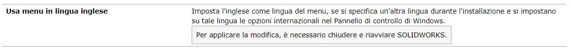

try to start solidworks in English, maybe looking for the string of error in English you can find more info on the net
