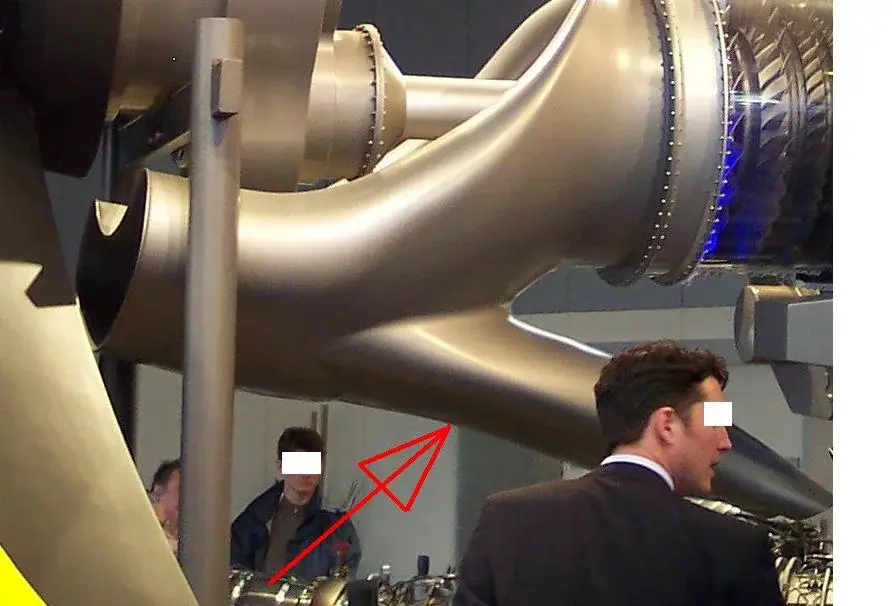

what you see is a "mockup" (model) old enough, probably accessories have been repositioned over time (including exchangers and their discharges).a curiosity:
what does the beak point down immediately after the main air intake?
All right, mo they invented the inverter!It's true he has the inverter! practically on the a400m two propellers turn in one direction, and the other two in the opposite direction (to better balance the plane boh?), but the 4 engines are identical for reasons of logistic simplification, therefore two propellers have an inverter between them and the engine, the other two do not.
