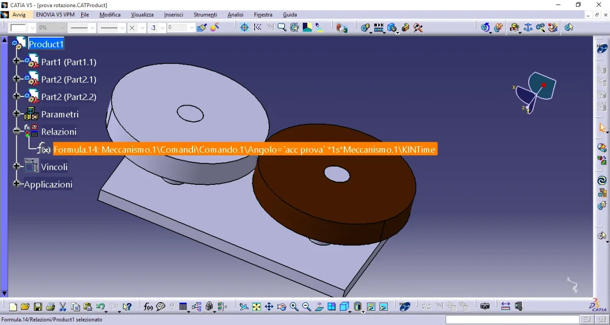

Hello, everyone. I'd need to know how to make a uniformly accelerated rotational motion simulation. I have created a simple model and in the law of the motorcycle I have inserted an angular acceleration ("acc test") but the simulation starts and remains at constant angle speed, in fact if I activate the sensors and control the graphs of the angular velocity are straight to constant values, something impossible if I have an accelerated motion, so there is something wrong. also visually it is evident that the mechanism does not undergo changes in speed.I want the angle speed to start from 0 and constantly increases in the time interval of the simulation. I put in the attachment some screenshots to clarify the problem better. Thank you very much
ps not succeeding in attaching the catproduct file I made it available on google drive at the link :https://drive.google.com/file/d/0bzlnzygwb_-jcxbkx1zilxd1q0u/view?usp=sharing
