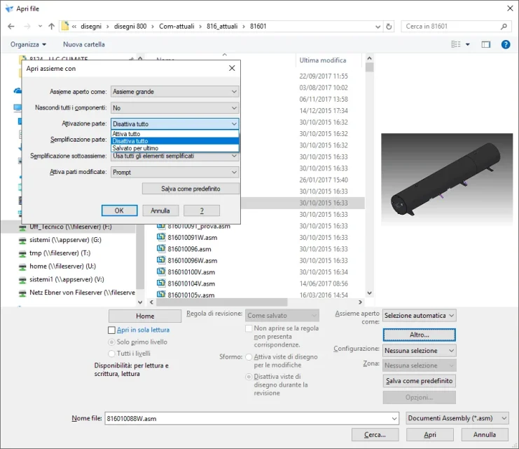

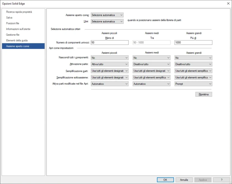

the way a set opens is governed by the settings made in solid edge:
asm open 1.webpif you then open a file with the "open" Solid Edge command and not with the double-click explorer you can choose how to open it
I had the st3 version solved through the solid edge open command and setting the activation as default. now activates them even if I open them with double click.
