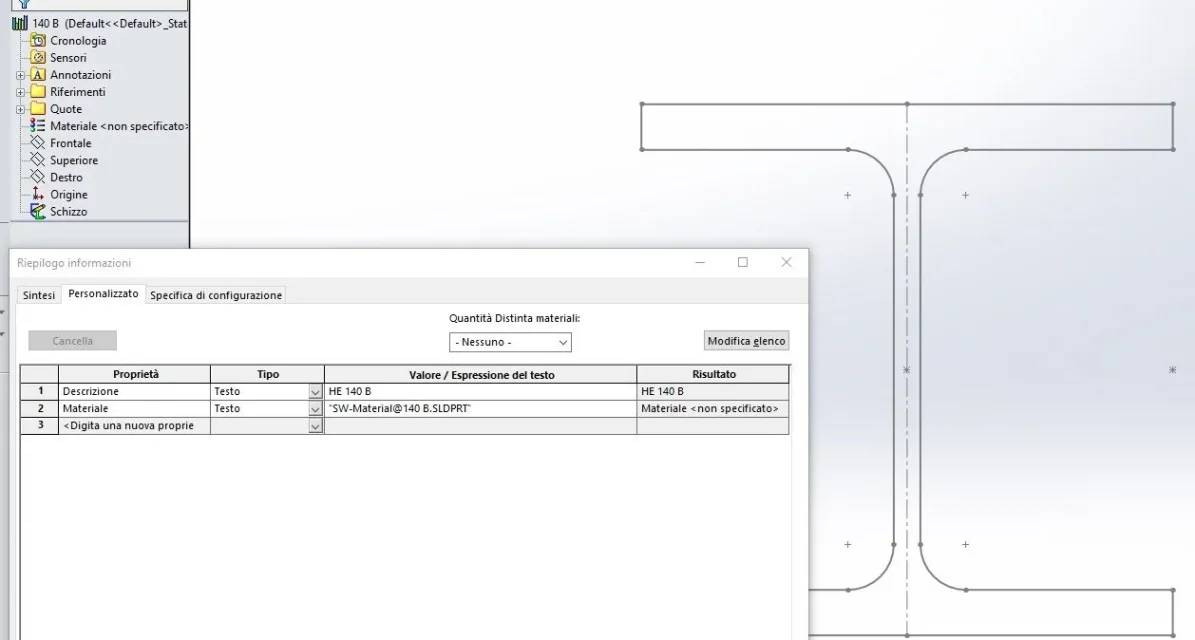

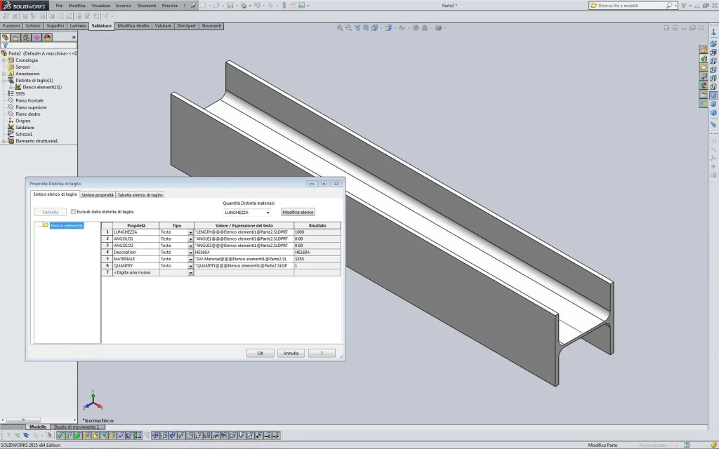

I should create a file for each profile but not enough. I attach a part screen with hea 160 and default properties appear.
if I add other properties like mass and surface, when I create another welded profile on the first I have to repeat the process because the properties are always length, angle1, angle2, description, material and quantity.Schermata.webpI am convinced that somewhere in the system there is a text file to edit. . .

you need to change the profile file (sldlfp) where you add the items you want.
the voices lunghezza,olo1,olo2, calculates the program at the time of creation, the others are already present in the profile, open it and see if I am not right.
in sequence:
profile with weight properties
profile without weight ownership
distinct with weight properties
distinct without the ownership of weightView attachment 40440
View attachment 40437There are no other manners. the work already done you have to do it by hand; to make a system first can be, I do not guarantee anything if they happen I have never existed, that to sequentially compile the properties on the first list then with the ctrl key pressed to select them and copy them on the other lists. or go to proprietary synthesis (second tab), select the affected item and where missing add the affected value/expression.

in case someone else was interested in the solution to the problem:
in the change of the entries of the "lib feat part" in the properties of the files (information summary) there is a "change list" button where you can add all the new entries and then make the choice in the drop down menu of the properties.
