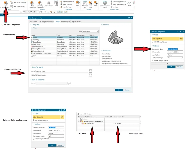

but how can I add a new component to a set and specify the file name directly? I tried several times with new component but the component that is assembled does not take the name I enter. file name and component name are two different parameters?
Thank you all.

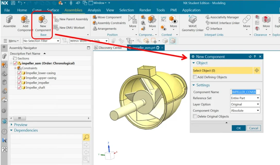

Among other things I found the tutorial below where they do more or less what I would like to do. I use nx 1984, perhaps there are differences with the version used in the tutorial.
ciao @hope You're messing up. the component name is not the part name, the tutorial is very clear and is doing what is illustrated in the image.
In the image I try to explain the difference between part name and component name.
