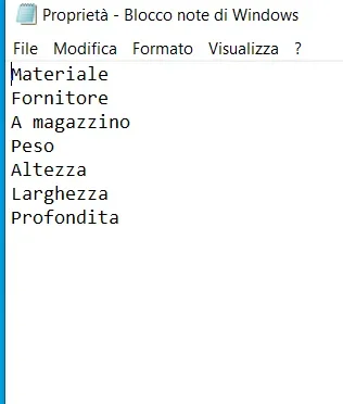

but do you mean properties already added?
I'll set you up a screen of my properties on txt
you can do nothing if you don't change them
in the future if you create a text file with writing:
material
Supplier
in stock
Height 0mm
width 0mm
depth 0mm
depth width height will pass you as length variables
all other string variables
