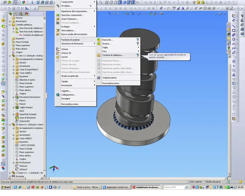

This is a figurative welding cord:
I wanted to ask if it was possible to change style in 3d.
The cord appears as a black and grey intermittent cord.
Are there any other types of cord or just that?
You didn't look at the right place.
but I speak of cord with connection e non del cord with welding.
the first is a function that you find for the frames obtained from a structural member of the type welds (but also when you work the single parts as I understood) while the second is a purely aesthetic artifice that you find instead both for the assemblies and for the parts.
not that it is the end of the world but it was right to understand.
thank you very much always for the attention.:finger:
