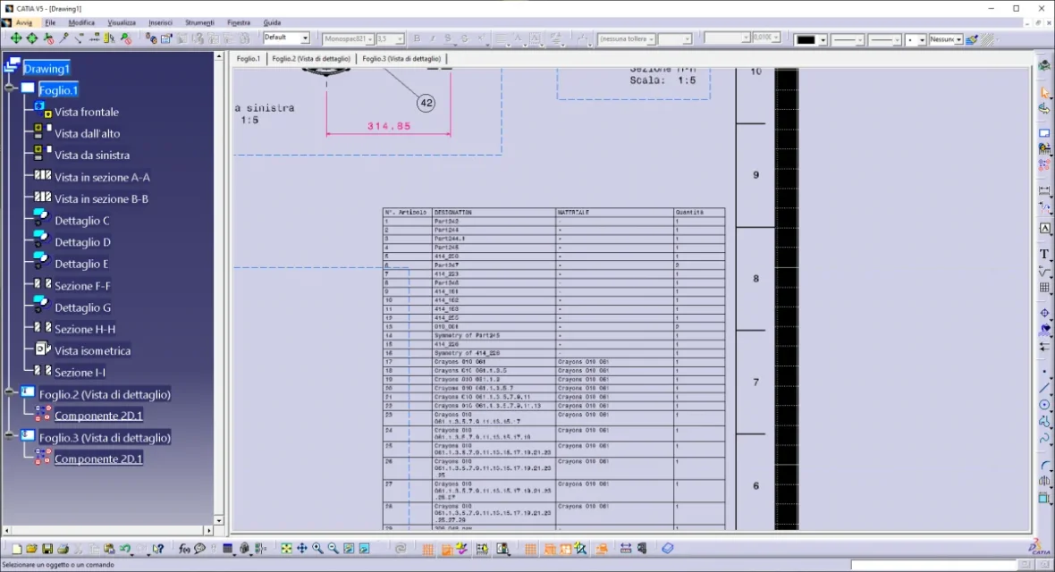

Good morning to all, I would like to change the texts in the advanced distinct. Is it possible or should I change the property of the parts? If so how. Thank you.
You can do it, but if you've set that advanced distinction must read the name of the catpart, you have to make a half revolution if you don't like that name.
alternative:
is to read the "nomenclature" rather than a variable set in the catpart.
to do all this you must enter as "administrator"
