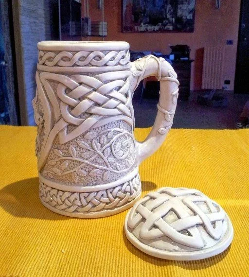

just to understand... .
for a similar bichiere ....zbrush or similarvichingo.webpfor a similar bichie .... rhino3dpunta_diamante.webp
