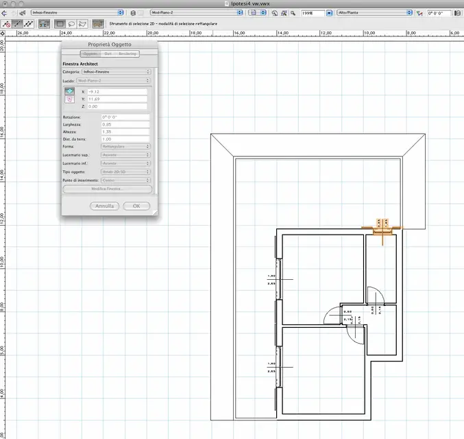

according to you why the window on the first floor and the door (created using the window tool as well as the 4 doors/windows on the other prospect) do not appear correctly?
I can see them in the frame!
are inserted correctly into the wall? You're told by the info stand.
or even, do they have filling?
I think there's a defect of insertion. for test I copied the two large doors of the ground floor by pasting them (reporting) to the first floor. because they were not in position I dragged them to the position now I get the same effect. I had also glued with the window in question while on the ground floor I had inserted the created symbol then changed it according to the requirements.
It's definitely my mistake of procedure.
Now I create them again and see what happens.

I'm sure the window didn't punch the wall!
How do I solve this? I tried to move her, but nothing happens. Where am I wrong?
verify that the symbol insertion option is activated. It's a key on the datebar. See when you activate the selection dart.
I do.
the fourth icon starting from left on the datebar, just under the pop-up of the categories.
I do.
I do.
Excuse me... I've seen it but misinterpreted. then the key is selected but nevertheless with this object I can not pierce the wall!
I have to decide whether to piss off and remake the rush or even try to understand the reasons calmly.
Meanwhile, I have to jump into a commune to discuss some chores. I'll talk to you later!
reinserting the symbol, clearly, everything has settled. I don't know why with what I had already placed I couldn't get him to drill the wall!
Okay, then you should see it to understand why it doesn't fit.
if you make it active from the resource shovel and click on the wall does not take it?
I do.
