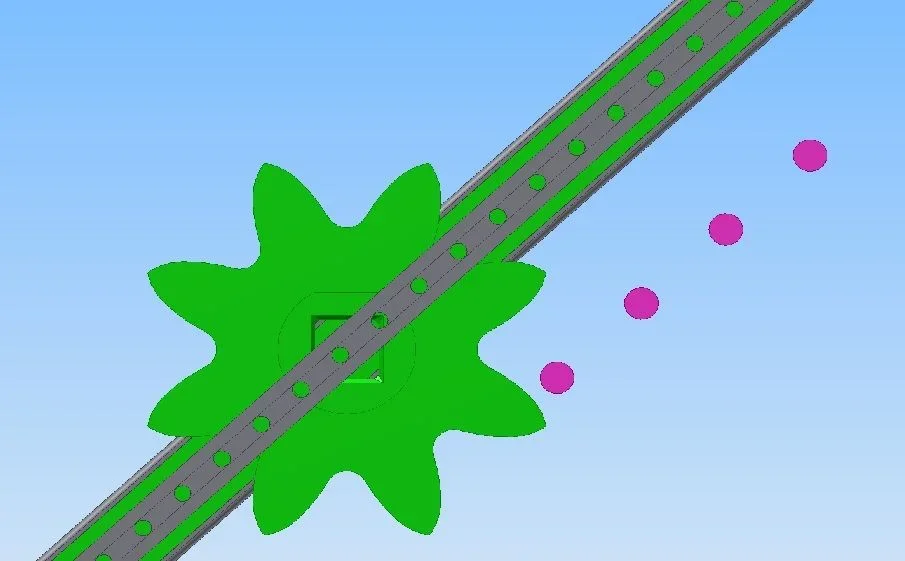

hi to everyone, I tried to search in the forum but I found nothing. I would like to ask if it is possible to create an animation with a pinion that passes along a chain and at a certain point carries out a rotation however continuing to transit. I know I haven't been very clear so I attach an image as a reference. .Ribaltamento.webp

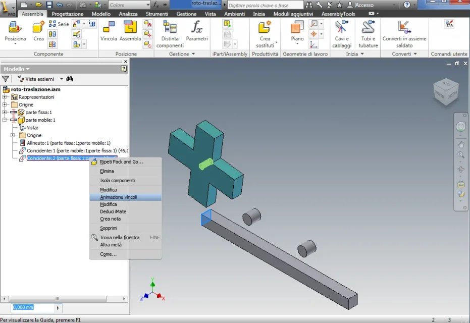

the contact resolver makes sure that the various parts of a set cannot compete, on inventor 2012 from the browser you have to select the parts that interest you and from the right-click selections "group contacts" then from the menu analyzes you have to press on "active contact group".
creates on the piece that must rotate a hole or a reference axis and binds the piece using that so as not to block the rotation. animates the bond that commands the position along which you have to move and you will see that when the green piece intercepts your pioli magenta it will rotate around.
I'll give you an example. .
