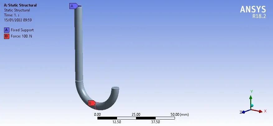

Hello, first of all thank you for the answer.we would understand how you are modeling the problem....to see from the section "geometry" recognized both solid elements and shell elements.
for shell elements you must necessarily define the thickness because, by definition, it is a 2d entity.
I'm afraid your problem comes from the modeling of the hook. try to model on a normal cad and export it as .iges or .parasolid then import geometry into ansys.
I have put more circles because I practically have the force applied on the circumference of the circle of halfway (the vertical one to understand us) and the other circles that are serving me because after I solve, I have to evaluate the tension on those sections practically.in the second image in the initial post show the hook made by a sweep (?), but since the section remains constant I don't understand why you generated multiple circles.
as the first step, with the current geometry, try to exclude the various shells that are recognized (click above with the right and exclude from the analysis). so doing you should see the whole hook as a solid on which you can generate a mesh.

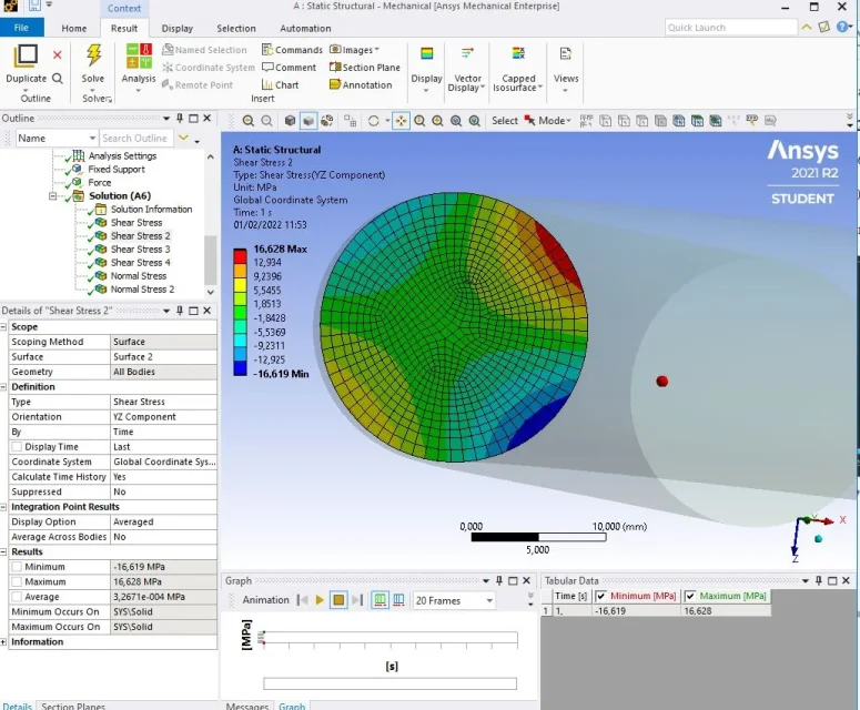

as you see from the half of the hook onwards (after the load) the geometry is completely discharged, condition that fits perfectly to the theory.
Finally plotted the equivalent stress (vm) only on named selection.
I hope I've been helpful

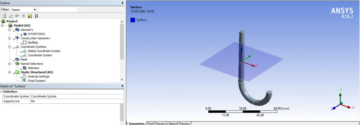

2. right click on "create surface costruction". automatic will create a building surface where you will plot tensions
3. always uses an equivalent stress (vm) but sets it as from below image.
Thank you very much, you were very helpful and kind, really. One last thing, to generate such a precise mesh as you did, did you use any particular setting?I forgot about a second method, maybe faster and more effective.
1. define n additional reference systems as many as the sections you want to do (attention to orientation, imagine the x-y plan of section)View attachment 643422. right click on "create surface costruction". automatic will create a building surface where you will plot tensionsView attachment 643433. always uses an equivalent stress (vm) but sets it as from below image.View attachment 64344

Guys, I still need a hand, sorry. I have attached, with the black background, the results of the tangential tensions that should go out, with white background those, wrong, that go out to me. I reported the results on the vertical section (where the force is applied) and on one of the oblique ones. I can't understand where I'm wrong.As for loads, I sent the attached photos first, on the different distribution. In fact, my doubt is about that. for the constraints I used the fixed-type bond, in the reference file instead uses displacement, but still gets a recess so I think it is the same.if the definition of loads and constraints is the same as that of the model you are replicating pays attention to the reference systems of your model and those of the model you want to achieve.
at the moment there are vague info to be able to give you a precise answer (in what exact point is the section that does not return to you? have you replicated exactly the same conditions as the pattern you are taking from? )
