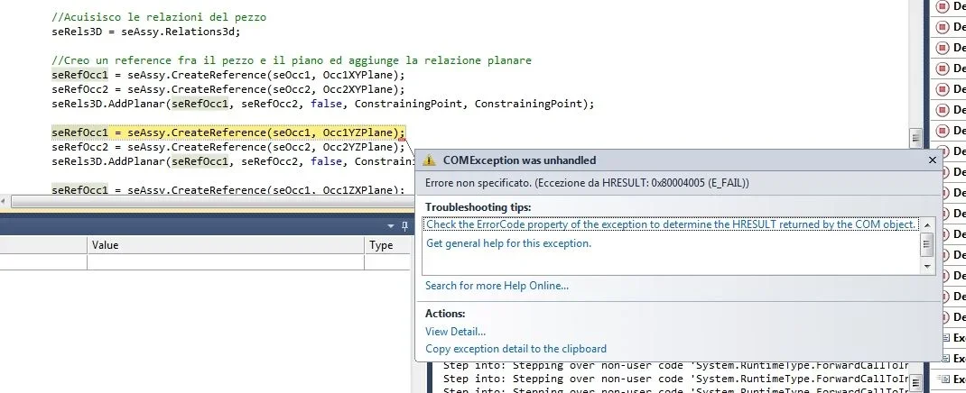

now the code works because the first two components are assembled perfectly, the problem arises in the second cycle. it still does the initial part without problems, but it gives error when it reaches the time to create the reference and then make the coupling. in particular it goes wrong on:
Code:
serefocc1 = seassy.createreference(seocc1, occ1xyplane);
I thought maybe it was because "serefocc1" was not initialized to "null", but also in that way it makes a mistake. I thought maybe it should be able to keep the old references, so I tried to make the second assembly with a different variable, like "serefocc3", but it also makes a mistake like that.
clearly to the second assembly "seocc1" is a different component from before, in particular it is the second that I assembled previously (what before was "seocc2"), and occ1xyplane is the xy plan taken from its coordinate system.
I don't understand what the problem is, and it's definitely solid edge. I obviously miss something about how the occurrences, the reference and the creatireference(), but I don't understand what it might be.
Does anyone have an idea what the problem might be? I'd practically finish this! !
I thank you again for the attention, you are very kind:

then I realized a mistake, in the sense that since all that code is called several times in fact is as if it was in a cycle, so at every time I tried to eliminate the relations of the two pieces that was assembling at that time, but clearly one of the two had already been assembled before and therefore the ground report had already been removed previously.
I modified the code so as to remove the constraints to all pieces except the first time the function is called.
I also initialized to "null" all variables so as to eliminate possible residual information.
now, after initializing to null, the program still assembles the first and second piece, then when the function repeats itself for the assembly of the second with the third one it blocks on the second "createreference", that with the yz plan. The error is this
err.webpIt's so generic that I can't figure out where you're wrong, so I said that I'm sure I'm missing something in the method of the creationreference(), the problem is that I don't understand what... besides the first creationreference() with the xy plan does.

occ2zxplane = seocc2cos.plane[SolidEdgePart.CoordinateSystemFeatureConstants.seCoordSysZXPlane];
            //acuisisco le relazioni del pezzo
            serels3d = seassy.relations3d;
            //creo un reference fra il pezzo e il piano ed aggiunge la relazione planare
            serefocc2 = seassy.createreference(seocc2, occ2xyplane);
            serels3d.addplanar(serefocc1, serefocc2, false, constrainingpoint, constrainingpoint);
            serefocc1 = seassy.createreference(seocc1, occ1yzplane);
            serefocc2 = seassy.createreference(seocc2, occ2yzplane);
            serefocc1 = seassy.createreference(seocc1, occ1zxplane);
            serefocc2 = seassy.createreference(seocc2, occ2zxplane);
I also tried changing the pieces, always nailed on the creation of reference between the piece and its yz plan, regardless of the coordinate system or the piece I take.
when it does it for the first of the pieces it works, with any other crash, yet with the xy plan it does not give problems and the coordinate systems have been built in the same way. I don't understand. .
in vb6 this is how I would do it, and it works.

your code is practically like mine, in fact also my works with the first assembly.
on the second assembly performs the addplanar on the first couple of floors (any it is: xy, yz, zx), then when I create again reference to call for the second time the addplanar always crashes on the creation of reference. and crash regardless of which floor you use! !
i.e. if I first do the xy and then the yz:
Code:
 set objocc1ref = objasm.createreference(objocc1, objocc1xyplane)
set objocc2ref = objasm.createreference(objocc2, objocc2xyplane)
call objasm.relations3d.addplanar(objocc1ref, objocc2ref, false, xyzpoints1, xyzpoints2)
set objocc1ref = objasm.createreference(objocc1, objocc1yzplane)
set objocc2ref = objasm.createreference(objocc2, objocc2yzplane)
fa l'xy ma crasha sull'yz, cioè su "set objocc1ref = objasm.createreference(objocc1, objocc1yzplane)"
mentre se scambio l'ordine facendo prima l'yz e poi l'xy:
Code:
makes the yz but crashes on the xy, "set objocc1ref = objasm.createreference(objocc1, objocc1xyplane)"
practically always crashes on the second reference, while the first always manages to create it, regardless of which plans I use! I tried with zx, same speech.
I don't understand what it's like. Why ever on the second?

verification
ok now I fix it, but he does not crash on addplanar but on createreference, so I don't think that's why.
I believe that we are creating seemingly valid relationships that create problems to the next ones.
have you verified the reports created in what state are they?
Thank you, I did as you told me but unfortunately I always find the same mistake.
Where do I see her? by spy I can't find the voice "reference".
I'm sorry to take advantage of it, but can I try to pass the 3 components I'm assembling? Maybe you see the mistake where I've been banging my head for three days. .
the problem is when creating the second reference between the third coordinate system of piece 2 (sc_join_upper) and piece 2.
