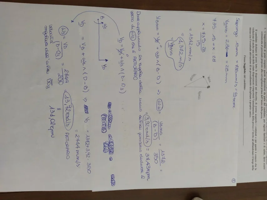

Can someone help me tell me where I'm wrong?

first of all, each variable you define would be well explained to the side of the sheet.... vbass vbtrasc vbam vbrel... You don't understand anything.
first error, absume vd nothing, you do not know why. if you do not analyze the system altogether you will never know if the do3 rod is rotating and therefore what is the speed of d.
then calculations db= 350 mm and vabe.
we turn the sheet and read “I suppose 15 mm = 735 mm/s = vbtrasc” ......
What do you suppose? So what is the calculation? Suppose a length and equals at a speed ... I do not want to imagine a professor who of these reads 120-150 per semester, what patience must have ..
and yet the first mistake I have highlighted.
You could start thinking about this.
is the same as the other post. you cannot write speed triangles for points that do not have an absolute reference in space. vd can be nothing a priori.
arrived at this level of modeling I think you have made her the cinematic closures with the complex numbers. I work all my analysis on those so I master those well. It seems strange to me that you do not have the foundations because you are asked for the analysis of this type of cinematism.
Okay.
then rod 01b I find the b absolute speed given by v(01)+w1•(b-01) (formula written in form).
v(d)=v(b)+w2•(d-b) and(formula written in form).
question: is the angle speed of the bd and d03 rod equal or not? Can you help me understand my problem, please?
vcomponents are not necessary to find trigonometric relationships and equations, just to disassemble the vectors (speed or force depending on the demand of the exercise) in the senses of the two axes x and y .. and to find the centers of instant rotation for each rod.

image.jpgyou place a methodical resolution of the first point, based on the closure of the speed triangles of the entire right kinematic chain (then excluding the main shaft of the mechanism that for this point does not serve).
as you can see, apart from the initial setting of the various rotating carriers that is simply a form of my minds without which I can not even make the additions, from the second brackets scratches on then you get a system of equations in speed in the two axes x and y, but by force of things in a non-linear system, because bd rototrasla, also depend on the position of the various rods. for this I told you that you can't apply the theorem of relative motions, assuming a priori that a point is still.
in the next steps basically I go to replace the values of the various angles in the equations. being, in the crystallized instant in figure, almost all oriented to multiples of more Greek several breasts and things go away and in the end you remain a system of very simple equations, omega function and angular position of o1b that allow you to obtain range_point and beta_point. You don't need to do that. range_point is the angle speed of the o3d rod.
It is clear that seeing it so the result can seem too simple for all the pappardellone I wrote. but it is because the exercise, intentionally, depicts the cinematism all in team at 90 degrees ... in general when these systems are characterized, especially in acceleration for the determination of couples and the choice of engines, we go to evaluate the entire arc of movement, because there is the possibility of impurities and strong non-linearity that to the eye can not be seen.
I didn't see the question. clearly not. In the moment photographed in the picture the equations simplify and does not make the idea, but seen globally (without simplifying the terms) you would realize that the equation of beta_point (angular velocity of bd) is strongly not linear and instant function of the position of other auctions.

If you take the relative motion theorem and the long x and y breaks you get exactly the same equations you see in the second system less than the last term I need to close the kinematic chain, but that is actually a fictitious rotary vector because delta is constant, then delta_point is null and in fact in the equation of speed is a useless term.
for the rest is equal to what you would get with the relative motions by disassembling on the two axes.
