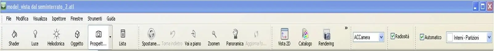

I attach the image of the toolbar. . .
I can select and apply a texture to any surface, only that selects also what I do not want to change, because in archicad I set them with the same material

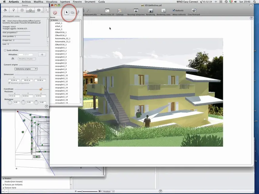

if you go to expire or in object you should be able to open a menu (on mac the interface is different) and from them you should be able to select.
l?icona should be the "usual" arrow of selection.
here is the screen of a draft. see in the open window "to flag" the arrow? ?

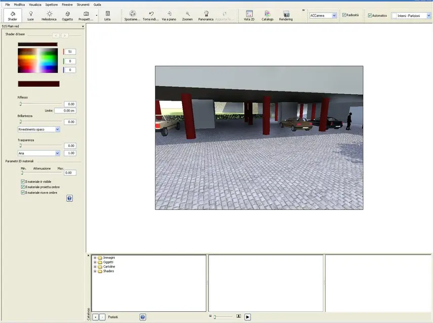

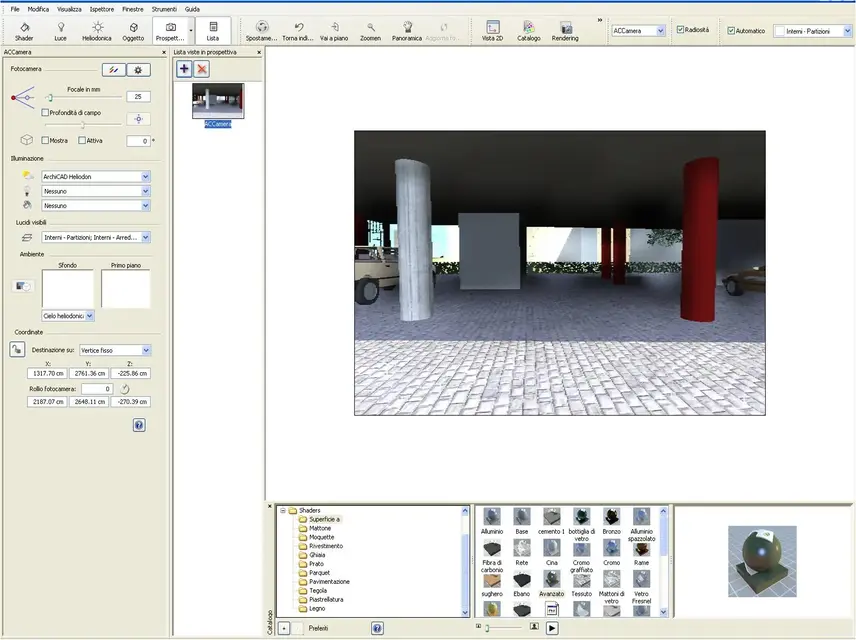

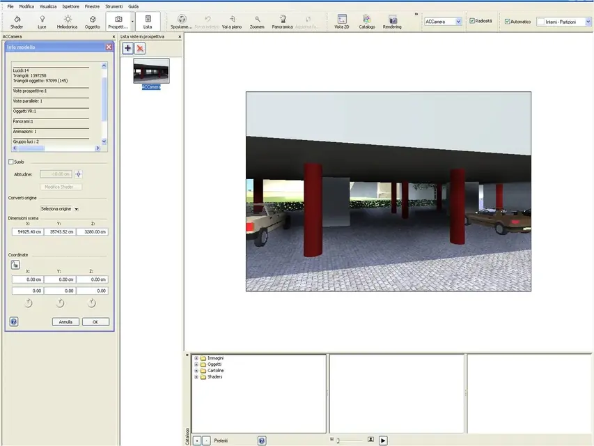

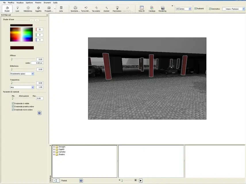

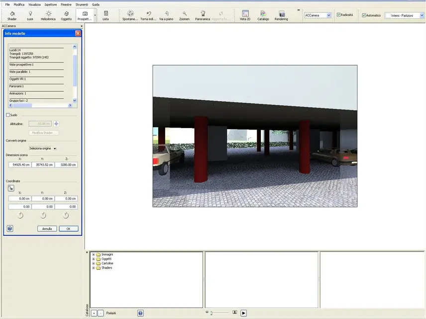

I put you two pictures to make you understand.
in image 1 the pillars are not selected. in image 2 instead yes.
as on archicad I set the same material to all pillars, automatically on artlantis me make them change all the same way
(in this case all red).
If I wanted to make only one of these for example yellow.. It doesn't make me select it individually. So, would there be a way to do that?

I understand what your problem is. Did you see that arrow in the image I put you?
once activated you have the option to choose different selective selection modes (see circled part in red). try what is most suitable for you to answer the problem. consider that those two buttons also find them in shader.

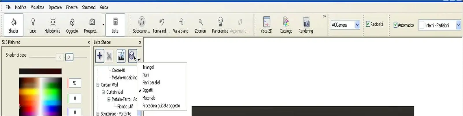

I clicked the list button and exit this...

Thank you so much marcogeo! I finally got it! ! !
However, for those with the same problem, in windows, the procedure is:
list > shader > activate the cube icon with the black arrow > bring down the drop-down menu > select one of the possibilities (object, in my specific case of the pillar) > select the add texture icon > choose the desired texture.
