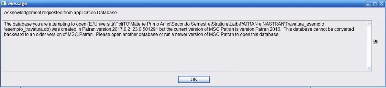

Hello everyone, I am an aerospace engineering student and I am approaching the use of patran/nastran software. I created a fem analysis on university pc with patran 2017. back home I go to open the file on patran 2016 and I get out of this message:
Cattura.webpis it possible to convert the file or not?
thanks to all in advance
View attachment 53640is it possible to convert the file or not?
It's not possible.
You have to save the bdf and then reimport the bdf into the oldest patran.
you can also save in groups in a .ses file. there is a utility on purpose.
but it is not the same thing that open a db. patran to each version not from compatibility with the previous ones.
