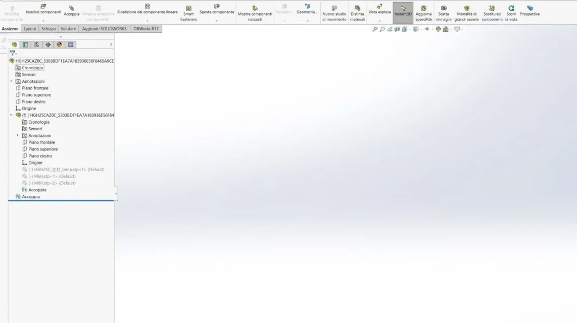

Why on sw if I try to open a step file this is not displayed to me? Does everything appear to me as in the enclosed screen?
or better, some opens them to me and others from this screen
because it has the suspended files. you understand that the names are written in gray
If they stay gray you did not reactivate them and are still suspended. Maybe he doesn't find them because he lost references
I unload a step file from the site and it looks so without parts, I open it in sw and it is a set. but I can't see anything in any way.
go import/export card options and remove the check at 3dinterconnect.
if it does not work attach the file.
