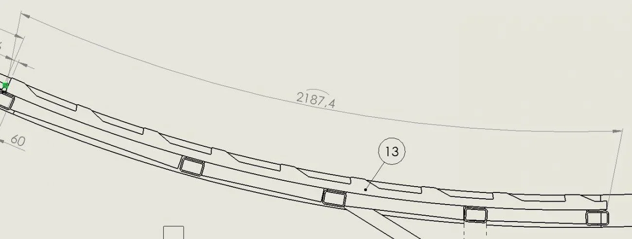

good morning, I wanted to know if it is possible to quote the length of an arc keeping the quota lines in line with the ends.
In the specific case, pallination 13, I tried by selecting the ends and the lower line of development, but it alone gives me the arc and not the development, while selecting the two lower points outside the end, it gives me the length of the arc (in theory it is the right one), but the odds are lined badly, I would like to hillside at the ends of the part.

this is the classic quote of the arc and is the one represented in the image of the 1 post. extension lines converge towards the center of the arch, while sp4rk0 would like to remain hilly on both sides of the square
in fact, I would like to be hilly with the ends, but if it is not possible patience, it is only a paturnia my aesthetic xd.

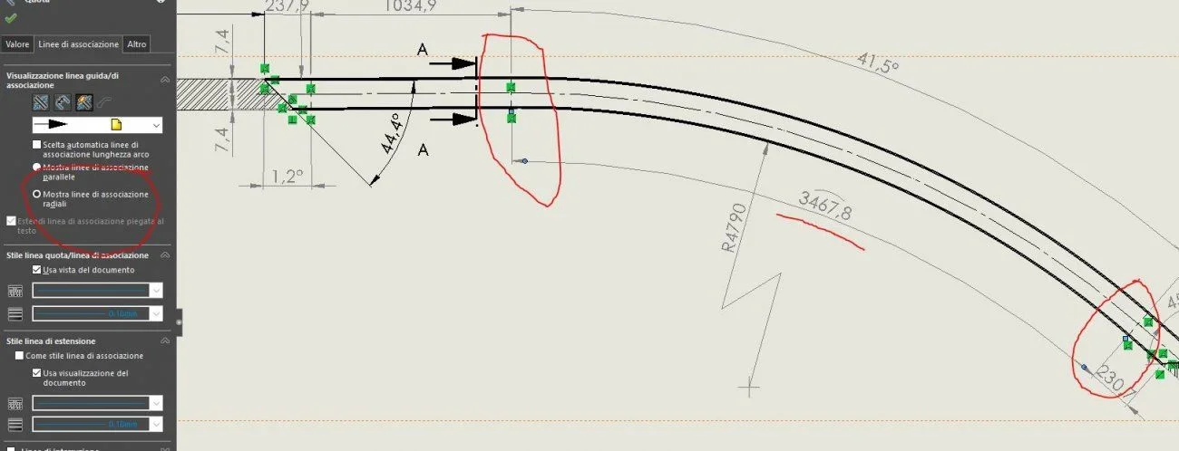

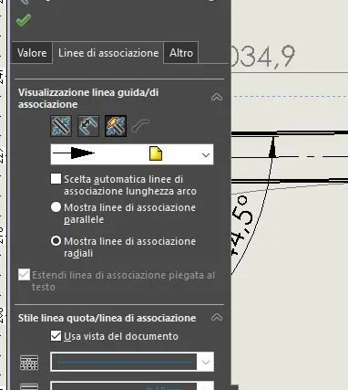

I found how to do it, if it can be useful to someone, on association lines, you have to remove the flag to the automatic properties and set them as radials, otherwise they always and however parallel.
