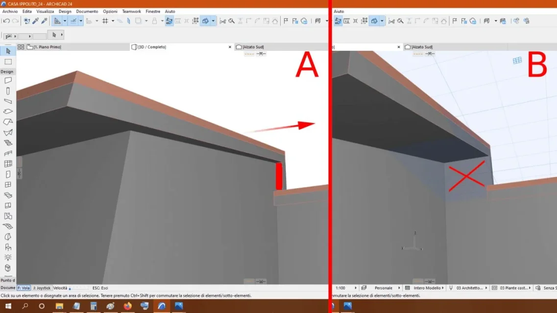

hi, did I pass there 24 hours to put on a ground that does not obey my orders and work on its own, at the time when I had to cut (by force) a wall that had in sharing 2 bonfires, a high and a low, from that moment on, the low ground depends directly from that high and therefore if I extend or shorten the high ground, the low in self-resolution only and above all eliminate that wall that is created automatically? see photo attached
Thank you! !

with a bolean operation in subtraction, going to remove from the main layer a solid parallelepiped having dimensions equal to the layer part you want to eliminate.
not knowing well archicad I propose this solution, but it is possible that there are more 'easy, for example the reward and drag (like the autocad) that allows you to easily eliminate the piece with only one movement.

or horizontally cut the ground to the level of the intradosso solaio, so separate it from the rest. otherwise the extrusion command will drag you the entire polygon (which in this case is formed to l)
