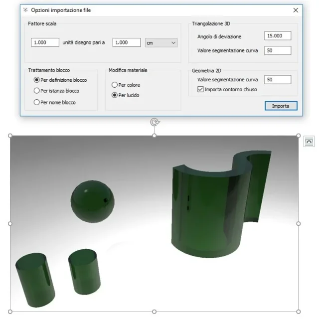

This is a problem that came out every time I had to make renderings in which there are curved objects. working the solid 3d part with autocad I set the facetres options with value 10, surftab 1 and surftab 2 with value 100. in the display tab of options to the resolution item I put 2000 as accuracy bows and circles. when we import the dwg from artalantis 4 it is essential to change the curve segmentation value. I have put 50 for both 2d geometry and triangulation. the more you increase these values and the more you slow the update of the images when you move in the window. I hope I didn't say crap.
