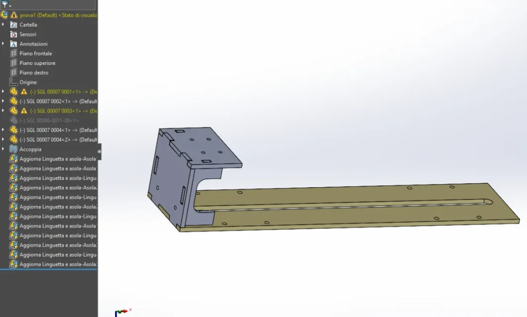

I would like to understand why this command, if there are many sunbeds and tabs, tongues disappear or become yellow. I'm probably wrong. also because the open part individually does not allow to change the tab or asola
I attach an example
I attach an example
the annex is incomplete, there are no parties.
Unfortunately I don't see anything that I have an old version. try to stay still with your mouse at all points where you find the error icon, and see if a message appears that illuminates you on the error. Could it be a face selection problem inside the tab command? Maybe inverting faces and vertices everything works.
Hi, I'm not very practical with tabs and sunshades, but one thing that immediately jumps to my eye is that the attached components are simple parts, try to remake everything using sheet-metal, the asola command works with the sheets (at constant thickness), and even if your part is thick solidworks you don't trust and you mark it as error. I don't know if I explained.
Wow, I don't know why I didn't get the notification and I only see now. actually could be that. Thank you
