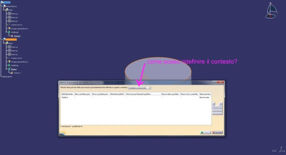

Good morning, I've got a problem with links inside a set.
these were made when this set was loaded into another set, so if I open the axieme individually it does not find the context in which they were made. is it possible to restore the context? and then redefine his links? of course without isolating the parts and do again copy/paste with connection.

This is not the problem, these links find them. in the images you find an example of the problem that I have:create product 1, then the byproduct 2 with inside parts 1 and 2. I create a body in part 1 and neck it with connection in part 2. if I go to open the product individually 2 gives me how to interrupt the connection between part 1 and 2. can you restore this link? from define contextual associations is it possible to tell him that the context is produced 2?

Hello nicola,
the only thing I've been able to understand is that in order to avoid the problem of keeping the product1 as reference (and therefore only the product 2) you have to have removed the check mark from the beginning: it uses the main context in the axieme
(menu/options/infrastructure/part infrastructure/generale/ uses main context in the axieme (check mark)))
and you have to do it before and not after...
unfortunately once made the frittata, my that it is not possible to reconstruct the eggs with the basic tools (the change menu is subevidenced,
other attempts to synchronize in the desk, I return an enovia window and stop them.. .
I tried to read the catia guide: product structure - definition of contextual links, but I came the headache.. .
