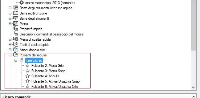

hello, could you say how to edit the acad.pgp file?? I've been trying for two days. in particular I have a mouse with two extra keys but I can not program them.. in the browser they make me forward and behind in navigation. I tried to edit the file in question but I don't understand how to attribute the command to the key. those already present refer to the keyboard
Thank you so much!!
the acad.pgp file is used to set the buttons.
