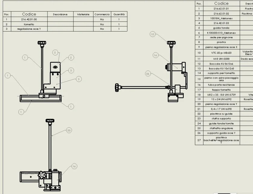

I would like to try to clarify an aspect about the bubble/tabel ratio.
It happens to have the need, even in the same table, to have both a table of only subaxis (sx view) as of all individual components (see dx). in this case I got the table to the left by clicking the view to the left and vice versa that to the right. so the bubbles mark what I wanted. However, for example, the view below took the criterion of the table to dx (single components) apparently randomly.
Is there a way to associate the bubble to a selected table? could also be there many more than two
