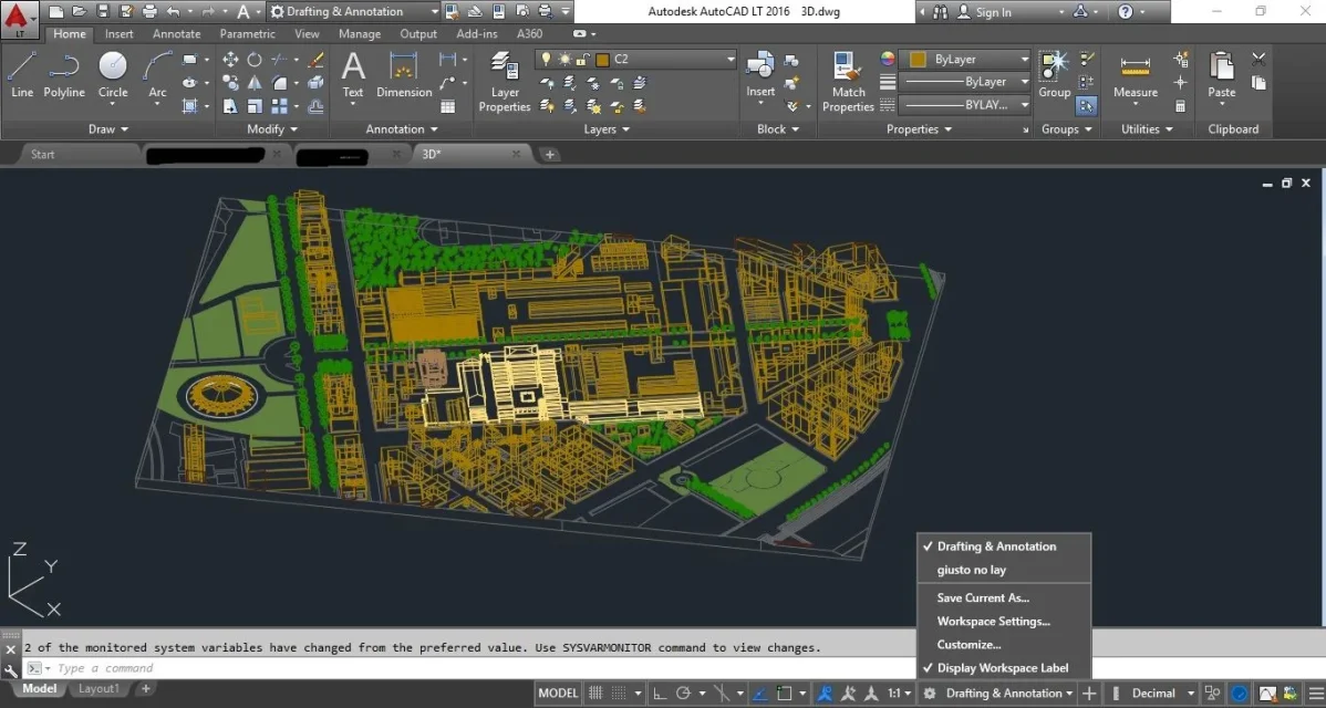

Good morning, I am a beginner of autocad 3d, or at least I would like to be. I tried to search the forum and found nothing about it (or maybe I didn't look good). there is no 3d modeling work space and I can't create it with customize. I also opened a dwg in 3d but do not appear the appropriate commands for the 3d, remain those for the 2d. Does anyone know how I can solve this problem? thanks in advance to those who will help me.
thanks to the answer, but unfortunately there is not among the working areas, I also inserted the image where you see...
What a fool! I thought so, because if I gave the polyline3d command, it made me do it... Thank you very much anyway!
No. and don't worry that you didn't make a fool of yourself, you just didn't have this information, even if for the usual users this is the abc.
