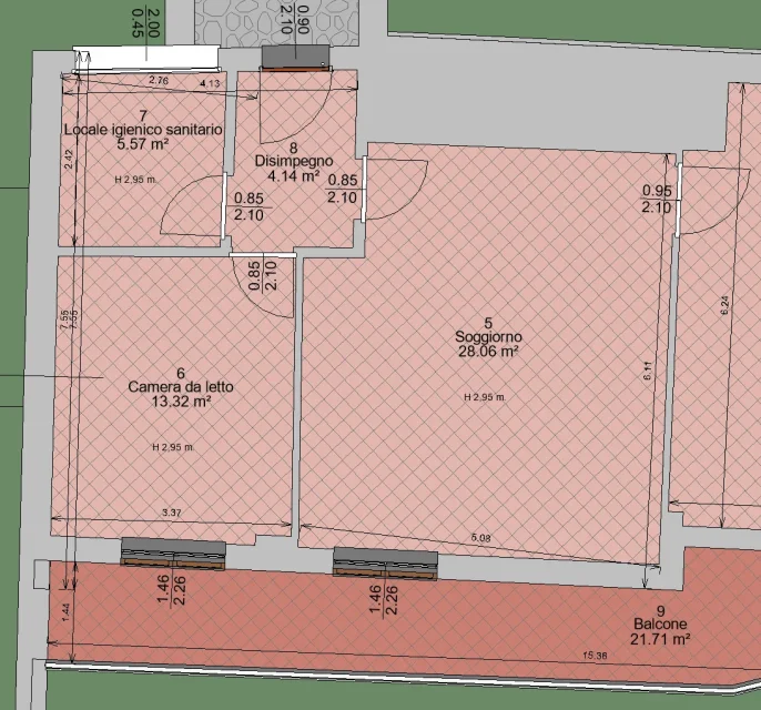

Does it also happen to you that the odds are moved by themselves when you change tab or reopen the project?
In particular, I have listed out of team walls referring to the points of union at the corners.
all right at the moment, but then reopening the project or changing tab, the odds move as they want them.. .
What do you think I'm wrong?
solved (my way);)
Therefore, in order not to make the quotas move, I have done so and seems to work:
in correspondence of the walls I recalcated the edge with pattern line,
then I started the aligned quota command,
I made cyclical selection at the crossroads,
I chose solo the intersection ball between the pattern lines (not those of the walls!),then I applied the custom quote style.
It would seem to work. . the only beat is to reload but it is always better than to move them all whenever you open the file.. .
