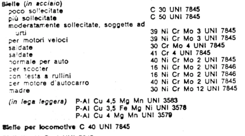

Hello, I am a student of the mechanical engineering course at the university "Wisdom". we are currently carrying out a project linked to the production in foundry, in particular of steel rods for naval motors from about 300 rpm and 2000kn of force in the head of the piston, contact you to ask which steels can be used in this field. I thank you in advance for the answer.
by exhuming a document that is about 30 years old, on material choice according to use, I propose to you these:
Screenshot_20240505_194559_OneDrive.webpOver the years, more or less convenient alloys have been adopted according to cost, stress and manufacturing phases.
