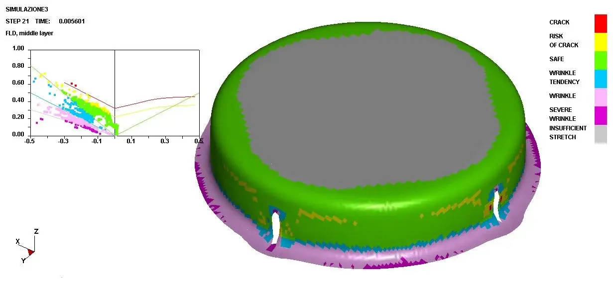

Hello, everyone.
As I had some free time, and these days it's not so strange, I allowed myself to do some molding analysis of the piece in question with the simulator we have here in company.
This confirms my assumptions made in previous posts, but especially to try to resolve the question put by zimmemme.
I attach two images of the results.
I have made two hypotheses of mold:
- traditional mould composed of stings, matrix and external primer that holds and accompanies the sheet during moulding. at the premier I gave 5 tons of pressure, while the sheet is a fep04 commonly used in vehicles with good printability characteristics. the initial development is that of zimmemme without the big central hole, this because it deforms so much so as not to allow even the forming of the piece. in any case the image highlights the goodness of the formed piece (green-gray zones) but the lateral holes were severely deformed. the raggetto at the bottom evidences how the starting development remained of the excess material in addition to the end of the flange following the ironing of the sheet during the molding phase.
- mold like the other but with central primer and use of the same parameters. in this case, during the molding phase, the part of the central plane is held by the primer, but the flange sheet enters the matrix as it seems and the final result is that on the flange there are wrinkles (blue/pink/violet). Also in this case the side holes are severely deformed.
Concluding, it results from the analyses carried out that it is possible to obtain a well formed piece and perhaps optimizing the initial development it is possible to obtain the flange with the correct height, however regarding the punctures these should be realized in a phase after the forming.

curiosity: what software generates that graphic analysis?
there are many, are molding simulators, used to see before throwing money into the construction of a mold, if the piece is feasible and what defects will turn out, giving the opportunity to improve the math of the mold in order to obtain then an optimal result.... some of these that come to mind, used x the automotive industry and not only, are: pam-stamp, autoform, dynaform, altar ... etc.
