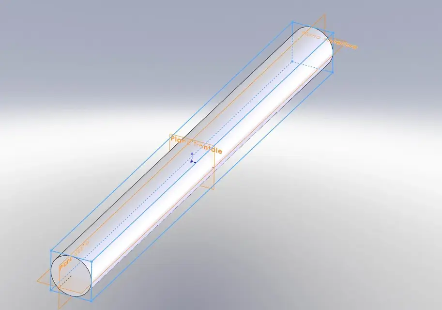

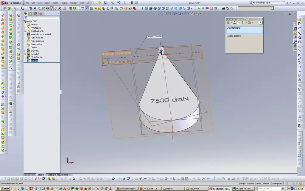

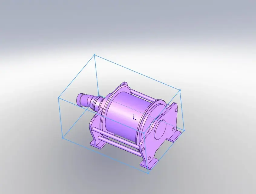

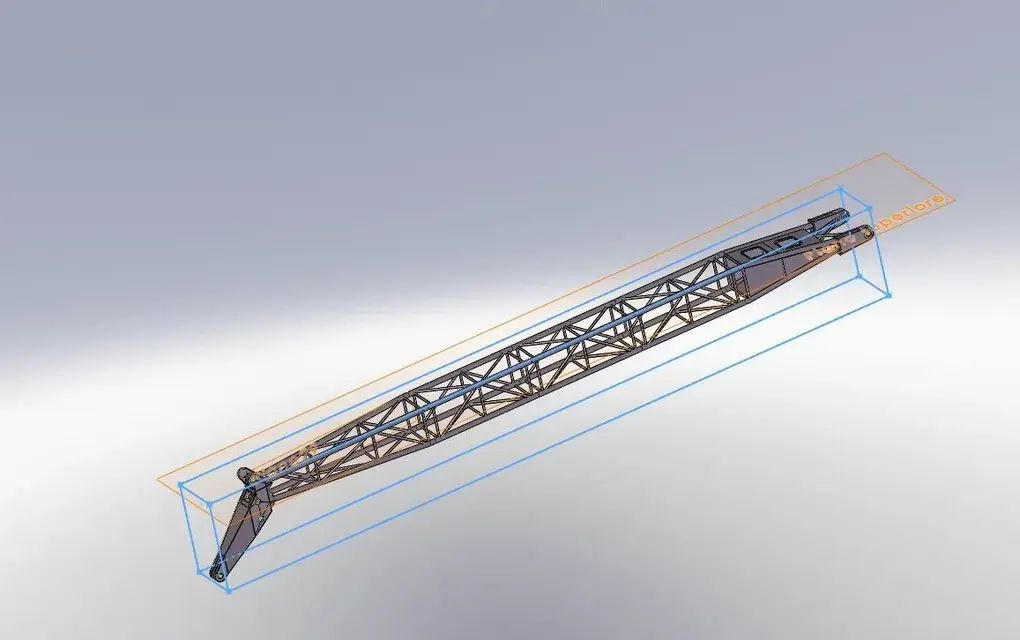

boundinghttp://solidworkstips.com/content/index.php/macrosI've done some evidence for my curiosity.
- always extracts a parallelepiped oriented according to the main plans(*); Therefore it is not as intelligent as you could claim but at least it is immediately usable.
- works on assemblies and parts (*)

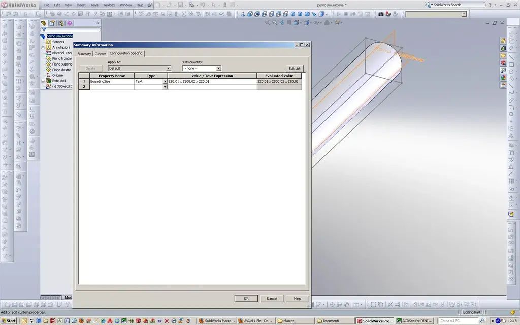

- adds a line with the newly calculated parallelepiped in the properties

shareware file is paid (the trial version has expired on the birth). as regards the macro at the link indicated by re_solidworks, as well as not working with elements placed on a terna other than the default one, does not generate three different properties, but only one with the three values. I also pose a problem, which is that of the fact that in some cases it should be done so that the three dimensions had a specific order as the indication of a measure before the others could in some cases decide some technical/ethical characteristics (in my field almost always). :wink:

the problem is that once the encumbrance is "freed", and a later size change is not recorded.
current use of quotas entered as annotation, recalled in the properties of the document. This way by changing the part, the encumbrance automatically updates me.
what I'm looking for is something that doesn't weigh this operation, I try to search on the net if I find some more flexible macros
