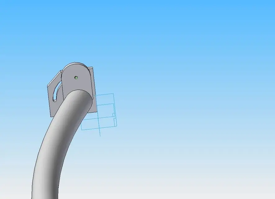

hello to all are a novice and I have a problem with solid edge, I should like in the attached design connect the folded tube to the rounded plate I thought it was enough to give the tube the axial relationship and me connected it to the plate instead does not make me connect them as I have to do? help!! Plus I have to give the relationship angle to the cylinder so that I can rotate it as I can do?? ? ki wants to make 1 work of good erudisca thanks thanks thanks:confused:

I would say that the best way is to do sketches in the individual parts and then jointly bind details through sketches.
Bye.
I often use the coordinate systems created in the parts, bind us the construction geometry and then use them to create the bonds of assemblies.
