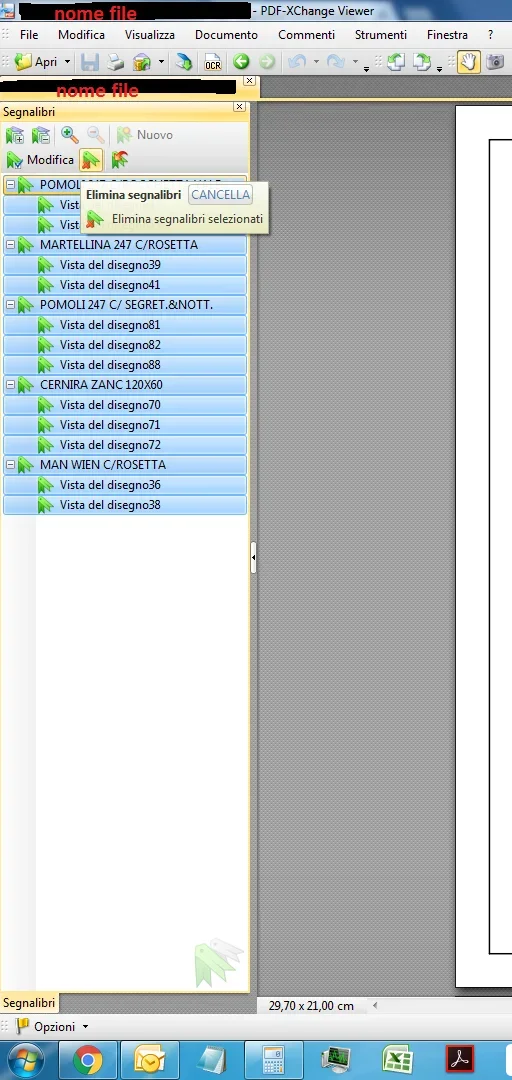

Good evening,
because of a problem with pdf creator [Bleep] I am forced to use the "Save Name" function to create pdf.
but when I go to save a pdf, automatically while the display appear bookmarks that I understood to be exactly the list "feature manager" within the framework design (I attach image by understanding)
Immagine.webpis there a possibility to use the "Save Name" function and then create pdf without having those bookmarks? I tried to look for both options, and on the internet but I didn't come over.

starting from the fact that it seems there is no way to exclude the export of bookmarks:
- if you have problems with acrobat pdf printer, try installing another virtual one.
- open it with an alternative pdf reader (I use xchange) and delete the bookmarks then unleash the file
- why are you so annoying the bookmarks that are nothing but links to their respective views?

riassumendo:there is no way of not having bookmarks if you use the function "Save with name" and then you save in pdf
(I use 2016, I don't know if this possibility was introduced later)
but! thanks to the good old boulders and its "xchange" you can simply take off after a drag and drop inside "xchange" and:
shift + click to select all and press delete bookmarks;
save;
now in pdf there are no more bookmarks.
