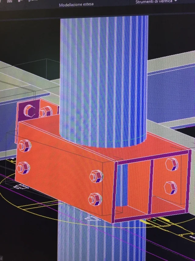

Good morning, I have a box created with plates and placed between two profiles. I rotated it four degrees and I'm trying to do it with a circular column. . I'm doing everything manually and I don't get a perfect job. I was wondering if someone can recommend me the best way to proceed...thank you. attached explanatory image. I am using advance steel 2020

Hey, how did you create the box? folded plate or rectangular profile?
the dish, even if flat bent, is seen as "a set of objects" (piatto+piatto+...) so that if you want to have the same processing on both sides (/plates) you have to copy it. You can also use advance copy.
hi after a few tests I managed to accomplish what I wanted. I've lost some time to understand exactly the procedure (custom law) but now it's pretty clear to me. I made the six dishes I needed and built the box. Then I made the holes and welds. at this point I made a custom joint that I then quickly reused on all other profiles. I attach image.
