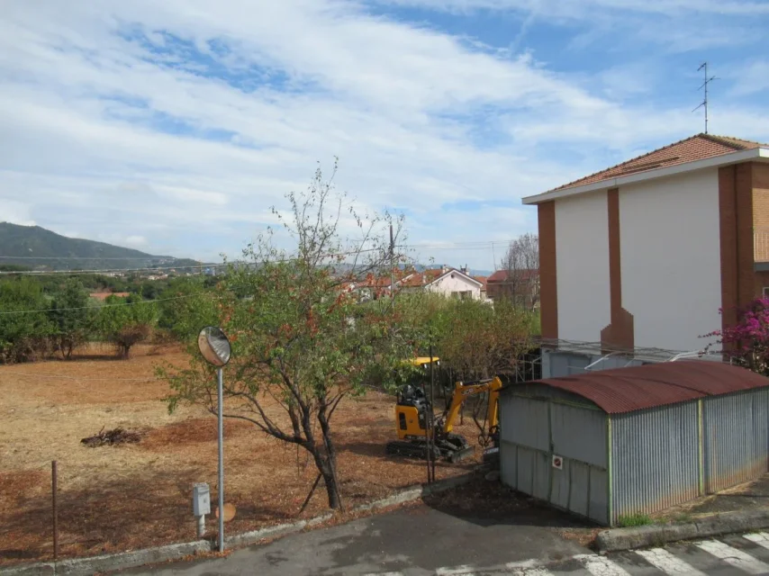

Hello, guys, did you happen to play a corrugated sheet box? ?
like this in the bottom right? ?IMG_5643.webpCould you help me understand how to build corrugated sheet structure and walls? ?
I'm losing my mind.....
thanks in advance... .
