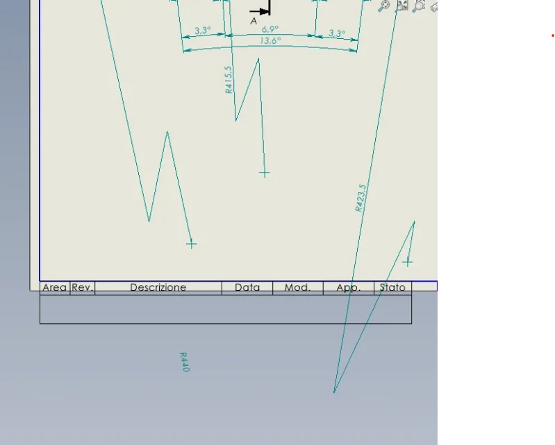

I would like to break a bit like you do for the views when you want to shorten.
Now I put an example.
radius 723 comes out of the drawing.
greetings
Giuseppe

click on the radius, property manager-line association and select the shortcut icon for the radius (the one where the radius resembles a lightning).
help: association lines.
search: shortcut

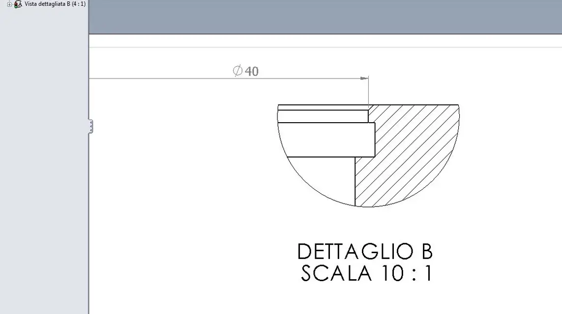

and if I wanted to do the same thing but for a linear quota?
I would like to shorten the ø40 quota, it is half an hour that I ride between online guide and forum but I do not cable the paws.....

then if you right-click on the quota lines (attention not on the quota text) you will find the "show/hide extension lines" and "show/hide the quotation line".
while for the extension line there is no doubt what is handled, for the quotation line depends on which side you click.
... right click, this stranger:smile:
there is a whole world below; try it all and everywhere!
and in case the quota is shortened to be able to keep it inside the sheet?
radius 423,5 doesn't want to know how to get into the sheet.. .

if I don't remember badly the lightning line was possible to edit it, that is to change the individual points as you wanted when creating every point of the lightning line you can move it...
Immagine 2023-05-09 085554.webpWhen you create the share of "discuss" you appear so each point becomes a square if you click on the square and hold and drag you will see that the points move.....
