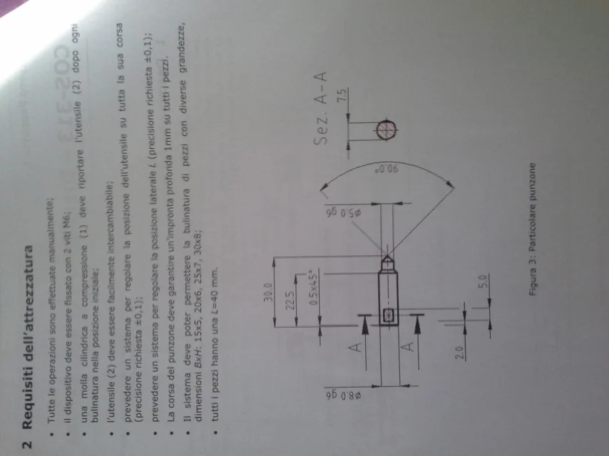

My name is ivan and I'm a mechanical engineering student. As you understand from the title, I am looking for ideas for a project that consists in the realization of a bulini equipment. I already have some point, but having little experience I may have missed something. among you will certainly be people with years of experience in the workshop or very good tools and that can seem to you a trivial theme.
I attach two photos with project specifications and a sketch.
If you have any ideas, I'd be very grateful.
Bye. It seems a little meaningless project for some aspects. However it is an equipment with screws to be fixed to the pallet with fixing wire din (cable to t). the equipment has a spring that recalls the punch after being hammered. the thing a little to pay attention is the discourse of depth of 1 mm, feasible with a bushing that makes out upward the punch only of the desired depth. clearly must be a hammerable surface.
for the recording speech just mount everything on two slides with orthogonal tab among them if you want to adjust in the plan. You can do the same to adjust in height. You're propoeing something that we're valuing.
you can also think of using an antivibrant or spring in elastomer that have a fairly high elastic constant with low strokes. to lock in the center to known thicknesses I would say that you can have blades to place and then do fine movement for the tenth
I'm sorry if I didn't stretch out the explanations but I didn't want to be heavy for the first time. Yes, the fixing is almost mandatory to use a mounting group with the appropriate nut for the t grooves, as well as the spring for the return. my variations to which I thought for the registration of the race is to use bulini with godronate wreaths or micrometric screws that exist on the market, while for the interchangeability I will use a simple grain or a screw with counterdado.
for the positioning of the punch I came in mind to mount u montante with its guides and a support slip while where I am more doubtful in the adjustments. I also thought of sliding tables with an endless screw but I never saw those that can adjust the table on both x and y planes while for the height they are at the high sea, I would not use other tables because I risk to complicate too much the equipment but the only thing that came to mind is a sliding bracket on a tooth block (normalized). other doubt is what if I implement these solutions, I fear that hammering the device, being also of precision.
