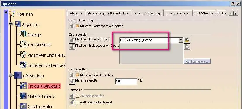

Hello, stef.
we cache option only act if you need it.
we have already set the path, in our case on the hard disk "d" d:\catsetting\_cache.
It's a little risky to point in the user's profile. if the user is not in company how do you recover his cache files?
with our solution you are independent.
connect to the machine and recover its caches.
It's just a tip...
As for the day option and now, from me it is blocked, maybe I have to enter as admin
