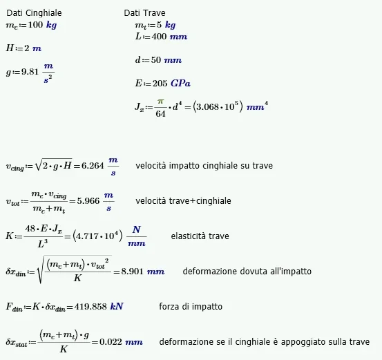

calculates the "spinta" exercised by a wild boar falling - resumption of physics 2 (vengement)
I wanted, by scruple, to perform the same analysis by making direct use of the response to the impulse always in the hypothesis of mechanical linearity (of which it is necessary to verify the validity).
the solution can be obtained thus: u(t) = i * h(t)
u displacement, impulse and response to the unitary impulse.
i = variation amount of motion which is mcing*vcing = 100x6,26-0 = 626 kg*m/s
setting to zero the damping hmax = 1 / (m * omega)
omega = square root(k/m) = square root(4,717e7/105) = 670,25 rad/s
umax = 626 / (105*670,25) = 0,0089m = 8.9mm
this value is to be considered the maximum oscillation around the value of the static case.
ustat = (100*9,8 / 4,717e7)*1000 = 0.02mm
the numerical solution therefore coincides with that of @f_ingrasciotta (the mass of the beam affects little. therefore consider it or not leads to significant differences).

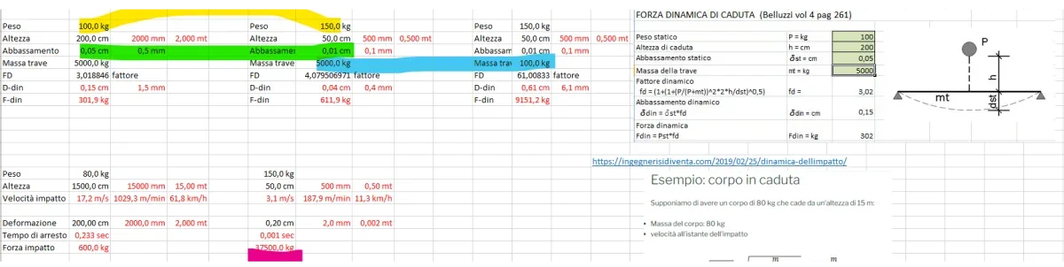

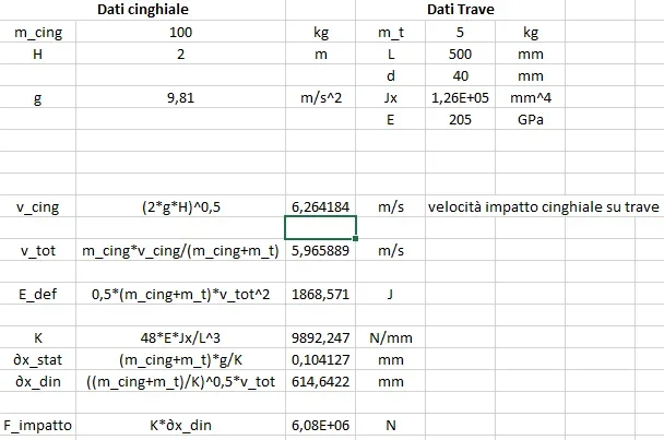

I have corrected the spreadsheet by moving me to another program in order to avoid possible errors on the units of measurement, as can be seen dynamic deformation is only 9 mm approximately, compatible with the theory of small deformations.
I said a good shit. with the value of 419 kn of load you would have a moment in the zone of half-carry pairs to 419kn*l/2=209 knm (with l=500mm). this value leads to "spatial" tensions so you do not remain in the elastic/linear field.

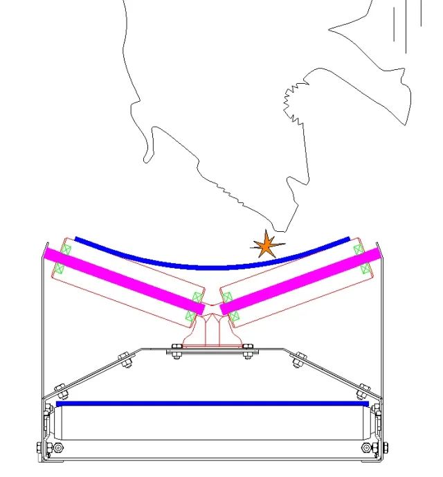

a question for @reggio: normally the hauliers' deservation carriers are placed on the move before the load is laid; Is that so in your case? If so, what is the speed of the tape?
