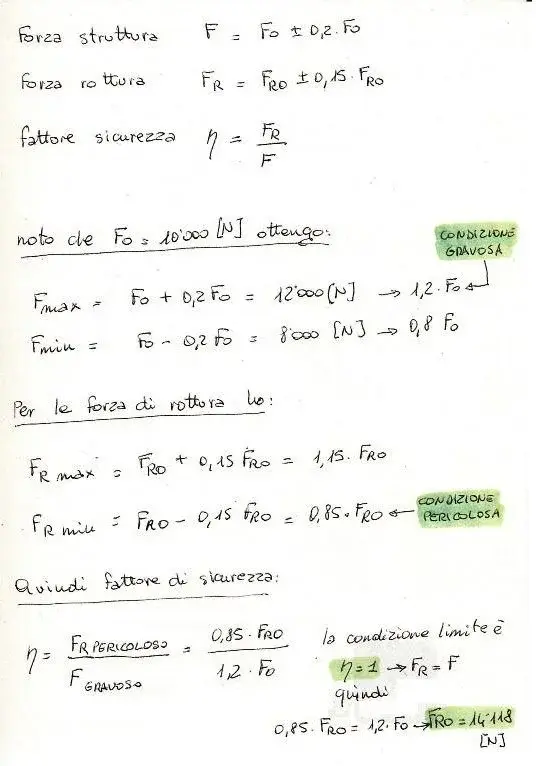

but the solution that you posted you weighed it from the book or is it your resolution attempt?
apart from that if you copied all the text, it is not very clear. I have reasoned in the attached way finding the worst condition of applied load and the lower limit that causes breakage. maximum scissor condition, i.e. material that breaks at the minimum of its resistance and force as much as possible to apply. of course for the safety coefficient should be imposed as follows:
1 = to obtain the limit value of fr0
1.5 = for ductile materials if fr0 is tied to the yielding load rs
3 = for fragile materials if fr0 is tied to rm traction breakage load
basically it seems to me a little intelligent exercise and that it doesn't need anything, but it doesn't matter, you've asked question and I have given you my interpretation.
the exercise was carried out in a partial way gave only the results I with a lot of patience and with other formulas came to that solution of the book but I did not know whether the procedure was right or not.... thanks always very kind, pearl workstation all in place the drivers for the video card released from nvidia still have some compatibility problem with the nvidia video cards ewin 7.
I hope I've helped you :biggrin: for the workstation I'm glad you've arranged at least the main things. for drivers we are always waiting for some really tested drivers to be released, then some tricks are always found :finger:

I can't find the result in your formula... according to the short track is the known term and is equal to 10000 while fo is the unknown then applying your equation fo=7083 from which the safety coefficient is 10000/7083=1.4
