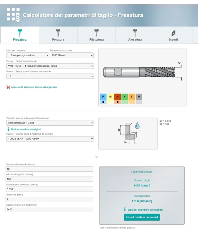

each tool manufacturer has specific data derived from general formulas but adapted to their tools; you can use an online computer type This is specific for this manufacturer; check if your tool supplier has a similar tool.
