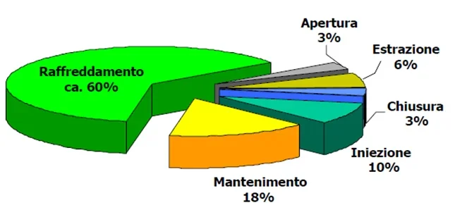

hi gorea, here you can not answer in words "poor", as for the specific pressure. .
Here opens a world. .
you place pictures, just to have idea how the cycle time is composed.
1693376565199.webpLets lose the accuracy of the % indicated, it is only to give idea of the phases that make up a cycle and the relationship between them.
from how you can see the main part of the cycle time is given by cooling time.
cooling time is determined by:
- material
- thickness and geometry of the detail
- capacity of the heat subtract mold (mould material, conformation air conditioning circuit).
- aesthetic - mechanical - dimensional characteristics that you want to achieve, which condition process parameters most connected to cooling time (injection temperature, air conditioning temperature).
