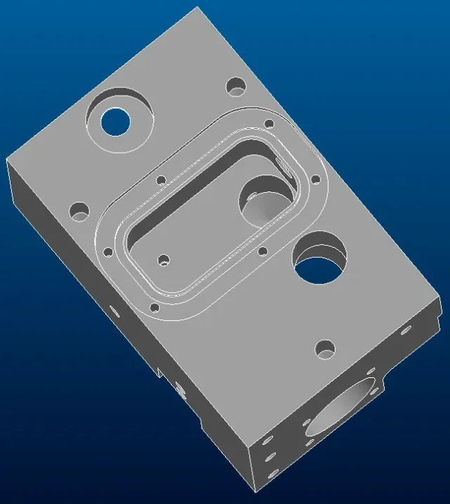

Hello everyone,
I need to calculate the volume of a shaped cavity (see attached image) obtained within a part, what procedure could I use to do so?
I hope that the programme will give me the opportunity to do so easily.
p.s. use wf5 and I have never worked with the surfaces.
thanks and good work to all.

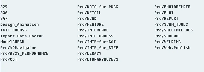

Do you have an advanced license for axioms? If yes, I answer you in one way. If not in another. If yes, you can keep everything together in an associative way without problems. If not, I think you have to make a family table. in any case you must use the surfaces, even if not advanced.
Bye!
or you could try to play with intermediate analysis between one feature to another, and then with relationships you get your volume by difference.
but of course it is a little more maccheronic and less elegant. If your geometry is quite "stable" over time could be fine.
in similar cases, see liquid tanks, I do so:
at the level of assembly I create a part that follows exactly the container using references, copy geometry etc. so that it remains stable even after any changes. By doing so it is elementary to set the filling level, calculate the volume, weight and I find in distinct also the amount of fluid to buy.
I don't know if this method can help you, you see.
If you have no interest in creating a set, you could select all the walls of your cavity, do ctrl+c and ctrl+v, in this way create the surfaces copy of the walls. then close your created surface with a fill both up and on the wall in front of your image where the hole is present. put the surfaces on. then create a cutting extrusion to eliminate solids. at this point you only have your closed surface, solidify and calculate the volume.
with this method however you have to use the surfaces even if not advanced.
Bye!
I don't know. I'll give you the detail of my license.
great viollo!! !
That's exactly what I was looking for, but I didn't have the necessary knowledge. ! ! !
thanks anyway to all, there is always to learn, good to make! ! ! !
