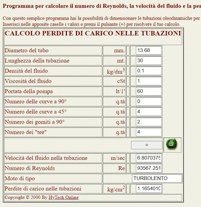

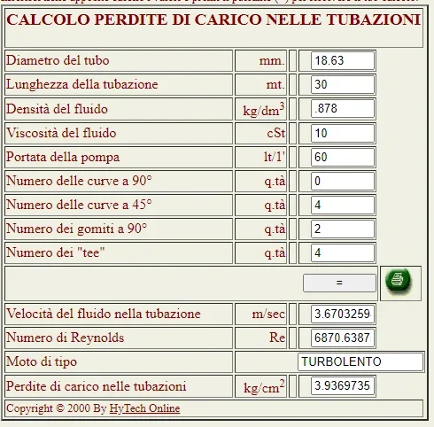

calculations that do not return on load losses

if I misjudge pressure and flow into two points of a conduct I must have the same flow (if I have dry feet) and two different pressures. the difference between the pressures depends on the roughness and v^2.

You're right I missed the double measure, I realized that one data was measured and the other estimated. the pressure of sending the measures downstream of the maximum valve?
